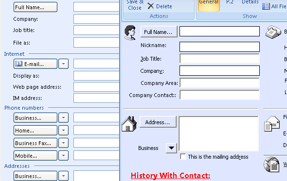

See screenshot - I changed the labels first then the bg. I used inactive caption text for this color.

That said, you can set a border.. and if you make the field transparent, it picks up the same color as the form. That is under "BackStyle" in Advanced properties. I would probably use it for labels - then you can change form colors as needed and the labels won't look bad.
There is also a specialeffect entry in advanced properties - you can make raised or sunken buttons.
I emailed you the forms which show the difference in the labels. Got them? Thanks very much!!
They look identical here. :) you can't use the pretty rounded buttons AFAIK - you can change the white fields so they are not sunken - that is SpecialEffect property. In my version in the screenshot, I have full name, nickname and company fields set to flat and used a dark border.

Same place you change the background color - right click, advanced properties.
You need to change the border (I used inactive caption so its slightly darker than my background) and special effect is set to flat.
thanks...but there is a misunderstanding....you are showing the field that i type in names etc.....please see the label to the left of it that has a title name....and that label field does not match the lable fields of the outlook 2007 form....understand the difference?
If you means the buttons, customized forms don't support rounded buttons. You can make the labels look like buttons by change the special effects property. They'll look just like full name. They won't be clickable though - AFAIK, you can't bring up the check number dialog.
Thanks again. To makethis clear, when you look at the Outlook 2007 default form, you see the thefields “Business” , “Home”, “Business Fax” and “Mobile” and the background isthe strong looking color (not sure how to describe the color) . And if you look at the same fields in myform, the background color is not the same. So it’s not the buttonsyou click on, it’s the left of the buttons. Make sense and then how do we design those fields to match the outook 2007 form please?.
Left of the Arrow button? With the labels business... etc? You can buttonize them but that is about it.
This screenshot shows you want I see - the gray buttons with the field names aren't used on custom forms.
Thanks so much for your time. Based on all you mentioned, I did the following and it does it:
As the fields where I want them to look like the box in the outlook default form, I made the specialeffect "raised" and then thru vaue, put them at the right level to the field to the right of them.
As to the other fields that have that background color that I don't need, I changed backstyle to "transparent" and it does it.
