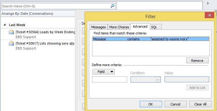

I wonder... if its outlook 2010. Randy and I are using 2013. I'll have to boot a VM with 2010 and test it.[DOUBLEPOST=1408425983,1408422904][/DOUBLEPOST]First filter: used filter dialog, messages contacts "assigned to wayne ivory", in quotes. Both messages show (and only those two)
Using a conditional formatting filter, only one of the messages is highlighted with the contains rule. Doesn't contain flips the colors.
What is odd is that both filters were identical and should work in the same any feature that uses the filter dialog.

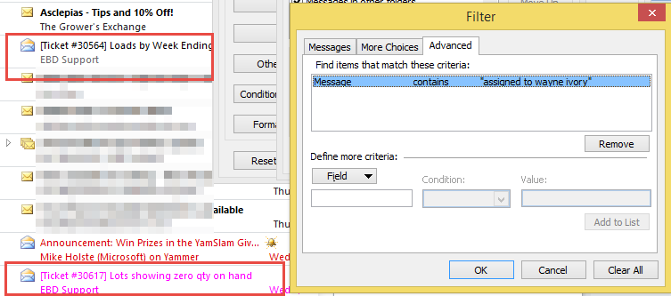

The plain filter showing both is what you want and conditional formatting behavior is wrong?
My screenshots last night are from outlook 2010 - my test the other day was in outlook 2013 and only involved the conditional formatting rule - one message was colored, one was not, depending on if it used contains or not contains.
I'm not sure I'm understanding your question correctly, but I would expect (and want!) the conditional formatting to show both the sample emails as you've used them in magenta.
I could have perhaps included a third sample email where the ticket was assigned to somebody else and would expect the first two to be formatted the same and the third to be different, whereas we are seeing the first and second appear differently.
By the way, all the email tickets assigned to others are formatted correctly. From my original post: I created the condition "Message" "doesn't contain" "Assigned to Wayne Ivory" and set the Font to "Grey". All tickets assigned to others are grey as they should be because they match the condition. Some tickets assigned to me are black (default) as they should be because they don't match the condition (i.e. doesn't contain "Assigned to Wayne Ivory" is false). It's only some tickets assigned to me that are grey - it's like Outlook is not seeing the phrase "Assigned to Wayne Ivory" in those messages via the Conditional Formatting filter, yet is seeing it using the plain filter or Instant Search.
