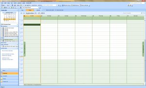

I'm not sure what the navigation page is, so I'll give you a shot of the whole thing.
Are you saying that the problem causing the non-display of events in Outlook exists in the cloud?

I'm not sure what is causing the problem, but I know if you are using the iCloud addin to sync with the phone, it sucks the contacts and appointments out of outlook and into it's own folders.
Ok... the screenshot tells me that you are using the calendar in the iCloud. So changing the pst was a waste of time, the appointments were not in it. I'm not sure if cleanviews works on the iCloud folders or where views are stored for this and because the status bar says 139 items instead of filtered, it's safe to say there is not a filter applied.
I would open the iCloud control panel and sign out then sign back in - might need to stick some voodoo pins in an Apple as you do it during a full moon with your eyes crossed. lol.
This will remove the iCloud database and create a new one and resync everything. And hopefully (if the spell worked :)), the view will work again. When you sign out it will offer to make a local copy of the appointments and contacts. it looks like you've done that before and as long as you plan to keep using the iCloud and everything is on the phone, you don't need to make a local copy.
YES! YES! YES! This works. The voodoo was successful. The calendar display came right back up after logging back in and letting the iCloud finish its thing. Thank you so much for your help.
