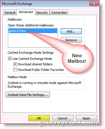

I have an issue with vba code when i use .getConversation.GetTable
If we are in mode "Online with Exchange server" or ""Connected to Microsoft Exchange" it's ok
But if we are just "Online" (when it's an Additional Mailbox), it's KO there is no line in the table.
additionnal Mailbox but "download shared folders" is uncheck
If i add an account for this mailbox , it's ok the mode is "Online with Exchange server"
What's the difference between "Online with Exchange server" and "online"
and why this code not get the same result ?

Conversations don't work correctly in shared mailboxes or shared folders and only the conversations in the current folder are shown (and it uses the subject to identify the conversation, not the conversation id).
I believe the differences better Online, and online with exchange is that online is not cached into it's own data file.
