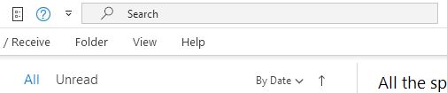

After checking various PCs, I think both issues (folder pane width cannot be smaller and search box in title bar or not) might be interrelated. See, the search box in the title bar is aligned with the left border of the message pane. Not being able to move the folder pane further left might prevent the new search box from interfering with the Quick Access Toolbar.

No, it doesn't interfere. It abuts it normally, and when you add a new Quick Access icon it just moves right a bit to accommodate it.

That is a plausible theory. It definitely moves with the border. The search bar is also the width of message list, to a point - but it has a max size.
