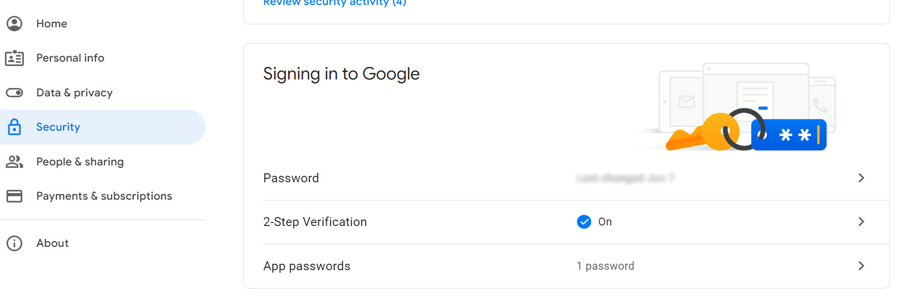

I followed what you said to do but once I get to where you say enable 2-step verification, I don't have "App Passwords'. I've been through all the settings I can see and nothing I see in there matches what you've said.
You should see it right under 2 step verification, here is a screenshot.

The 2 step verification would only send you a text if you or anyone else tries to sign in your email account from a diffferent device. As to what Diane said, I guess all you'd have to do is upgrade to a newer version. Here is a tip. DO NOT buy it from these online places that offer low low prices. I tried that and couldn't get it install becasue the key has been activated too many times. these places sell the same key many times so be careful. I bought Office 2021 from Amazon.com for about $220 well with it since it will last 10 years easy. just my opinion.
You have POP in your profile... FC has IMAP. Not that people can change and not update their profile (or be like spammers and pick the first options).... but unless something in the text leads me to think otherwise, I'll go with it. :)
I'm using IMAP to connect my Outlook for sending/receiving emails ... and it's Outlook 2010 I'm using.
Only Outlook 2016 and newer support oAuth2, which is what is needed when allow less secure apps is turned off. So you will need to use 2-step verification and then use an app password in Outlook in place of your password.
Outlook is very good about remembering the app password -so once you set it up, you shouldn't have problems. Even on the versions that properly support 2 step, they ask for confirmation once. Windows 10/11 even remembers the confirmation and will usually let you create a new profile and not ask for it again for Outlook.
But that is only in the newest versions... you will need to use the app password in outlook -should only be asked for it once, but if you make a new profile, you'll need to get a new app password.

If you have Gmail set up as POP account, you need to enable two-step verification and then use an app password in Outlook (all version). Update the password (using the app password) in File > Account Settings > Update password if the enter password dialog does not come up.
