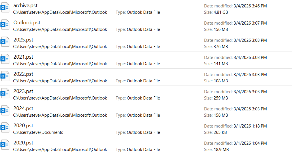

I searched for all my .pst files in C:\, and in addition to the 209, 217 & 223 .psts, these are the ones that showed up.
However, they were last updated when I still was using Outlook 2007, as you can see by the dates, 3/4/26. Also, I have used the archive file today, and a few times last week, and if it was used today, it should have today date on it, shouldn't it ? So basically, I don't know were these below Outlook Classic psts are.
That is the old path - newer versions of outlook use documents \ outlook files for default pst location. (Easier to backup when in documents.)
Are you are using copies? Right click on Archive name in the folder list in outlook and choose open folder location - or in File > Account Settings > Account Settings > Data files tab - what is the path to those pst?
If you don't have them in the new Outlook profile yet, move them out of appdata path and into a folder in Documents or anywhere that will be easy to backup. Then open them in Outlook.
Ok, thanks. I was able to find where I put them during my conversion. They were in my data drive D:\., and the the dates are updating when I add to them, so it is working. And are showing as e.g. archive.pst. And I do have easy acess to them as needed on the left side panel.

Nope, no need since you found the ones you are using. That was only if you were going to use the ones in appdata or are only backing up the ones in documents. But depending on your backup method, you might be able to include the PST in the D drive.
I can be easier to have all PSTs in one folder though - so if some are in docvuments and others in D, they could be all together.
