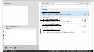

Thanks for the provided code, however, I think I misinterpreted on the requirement. See the included code and attached screenshot I took. When the code shoots off, MS Outlook activates Oracle subfolder, which is located under Inbox in my account. What I wish, instead of changing the destination folder in the line “\\mymail@domain.com\Inbox\Oracle”, a pop-up window, similar to InputBox pops up and I could put the full path of the email folder / subfolder, for instance, “\\mymail@domain.com\Sent\Invoices”. I hope this time I made it clear.
