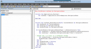

In my macro window I see the following.
Sub ThisOutlookSession()
Dim WithEvents objPane As NavigationPane
Set objPane = Application.ActiveExplorer.NavigationPane
Private Sub objPane_ModuleSwitch(ByVal CurrentModule As NavigationModule)
Dim objModule As ContactsModule
Dim objGroup As NavigationGroup
Dim objNavFolder As NavigationFolder
If CurrentModule.NavigationModuleType = olModuleContacts Then
Set objModule = objPane.Modules.GetNavigationModule(olModuleContacts)
Set objGroup = objModule.NavigationGroups("John's Contacts")
' Change the 1 to start in a different folder
Set objNavFolder = objGroup.NavigationFolders.Item(1)
objNavFolder.IsSelected = True
Set objNavFolder = Nothing
Set objGroup = Nothing
Set objModule = Nothing
I've attached an image of my editor window.

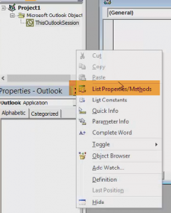

Delete this line: Sub ThisOutlookSession()
It belongs in the ThisOutlookSession module.
Screenshot: http://screencast.com/t/vlK3hdwpg
Quickie video - no sound because everyone is asleep -
http://www.screencast.com/t/vgYOT6bRs - when macro quit just after the line with John's Contacts in it, i paused the recording and added a 3rd contacts folder before changing the name to match my group name (My Contacts) so you could see it work.

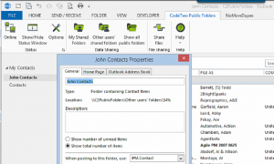

Another question - Note in the properties image I've selected "Show total number of items", I also selected this option for the Contacts folder as well. However the setting does not stick, when I close/open outlook I will not see the number of items displayed. I don't think this is an issue due to the shared folder because on my desktop I have a folder named "PM Contacts" and I have selected this option but the number of contacts is not showing. If I change to the other option and back then it will display the number of contacts but it is highly likely that the next time I open outlook the number of contacts will not be displayed.
I'm guessing this is related to CodeTwo folders. The only time I've seen setting not stick was if Windows installed an update or you clicked ok on one dialog then cancel on the parent dialog to close it. This one doesn't have a parent dialog so its not that.

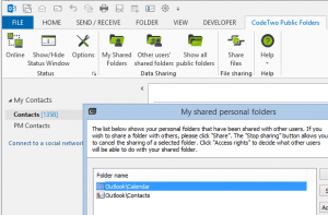

On my desktop which is the master for CodeTwo folders I have two folders under My Contacts, e.g. Contacts and PM Contacts.
  1. I created the macro and attempted to default clicking on People to bring up the PM Contacts. No matter what number I put for objGroup.NavigationFolders.Item it defaults to Contacts, e.g. the first one in the list.
  2. Clicking on the Run button in the VBA window still brings up the pop-up for the macro name
  3. I clicked on Properties for both folders (Contacts and PM Contacts) and selected "Show total number of items" and the number is displayed for each folder. I close/reopen outlook and only the first folder shows the number of items. Currently the PM Contacts is not shared out via CodeTwo. Currently only the Calendar and Contacts are being shared via CodeTwo.
This system (my desktop) is running Win8.1 x64, Office 2013 x32
FYI CodeTwo involves two installs
  1. Master - this is only installed on one system. For me this is my desktop known as S4
  2. Client - this is installed on all systems that will be working with the shared folders. For my install this is installed on my Desktop (known as S4), my laptop (Known as W700) and my wife's laptop (Known as Lenovo-Z580). Potentially I can share any outlook folder as well as any folder on my PC via the CodeTwo install. Because my systems are on a local network I don't plan to use the PC shared folders function. However I may change my mind after I learn more about sharing folders. BTW CodeTwo Public Folders also provides the sharing (Outlook folders and PC folders) via the internet but I'm not using this function. The Share Files function allows the user to share any PC folder from any system. The main advantage of this function is that when anything in the folder is updated on any system all of the other systems see the update in real time.

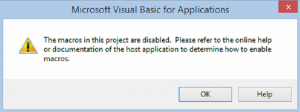

AHHHHH I think I just found something! The macros are disable on all of my systems in Outlook (see the image KMT Macro Disabled.png). I attempted to read the help about turning it on (by clicking the Help button when the window was presented and reading http://technet.microsoft.com/en-us/library/ee857085(v=office.15).aspx#changedefault) The info just went over my head. By chance do you have instructions for dummies?
OK more searching on the web and I found some simple instructions at http://www.extendoffice.com/documents/outlook/1368-outlook-enable-disable-macros.html As it turns out I need to select "Enable all macros (not recommended; potentially dangerous code can run)" - I selected this

Did you restart Outlook after enabling macros? (Outlook usually tells you they are disabled when you try to one them.)

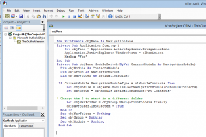

I'm still having an issue getting the macro to run at startup. I'm working on my desktop mainly because it is much faster than my other systems. I found one of your videos at http://www.slipstick.com/developer/how-to-use-outlooks-vba-editor/ (super) and I've watched it several times trying to see where I've made a mistake.
Is the macro security resetting to signed macros only?
I don't think so. I checked File > Options > Trust Center > Trust Center Settings > Macro Settings and it is still set to Enable all macros (did I answer your question correctly?)
Currently if I open VBA editor and change the dropdown to Application I can run (click on the run button) the macro and it works. As a test I made some changes (see S4 Test Macro 01.png). The main changes to to maximize the outlook window and to popup the message "Foo". On this system I have two contact folders under My Contacts (Contacts and PM Contacts) and after running the macro when I click on People it shows "PM Contacts" as it should.
Now if reduce the size of the Outlook window, close/restart outlook the macro does NOT run, e.g. the window does not maximize, I don't see the pop-up message and when I click on the People icon the display defaults to Contacts.
After watching you video several times I created a digital signature and applied it (see S4 Digital sig.png). I then changed the security level back to Notifications, close/reopen Outlook the macro does NOT run. If I open VBA and attempt to run the macro I get the message that macros are disabled.
From this test I assume that I did something wrong but I have no idea what that is. Again I watched the section about digital signatures and I think I did it correctly but I'm not willing to state that as a fact.
As another test I closed Outlook, deleted VbaProject.OTM, opened Outlook and recreated the code in ThisOutlookSession. Possibly when I do this I'm doing something wrong. I opened VBA, selected ThisOutlookSession, in the window on the right I pasted from the clipboard the code (I had saved the code in a txt file).
Thus I conclude that I'm still doing something wrong. The only good news at this point is that I believe I'm doing the same wrong thing on all three systems. :)
I've searched the web for postings for ThisOutlookSession as well as Application_Startup. I found postings that seemed to be similar to my issue but none of the suggestions resolved the issue. Anything I have found on the Microsoft site has totally confused me
I'm not so sure you are doing anything wrong - this behavior is not normal. It should run...
One posting I found said it worked when he switched it to
Public Sub Application_Startup()
When he switched back to private, it kept working. I'd try that...
This one of the things I tried without success. I just gave it another try and no success.
I changed to Public, closed/reopened outlook, (the window was not resized as it should have been) clicked on People (Outlook 2013 x32), the wrong folder was selected. I changed it back to Private, retested, no change, e.g. not working as expected.
