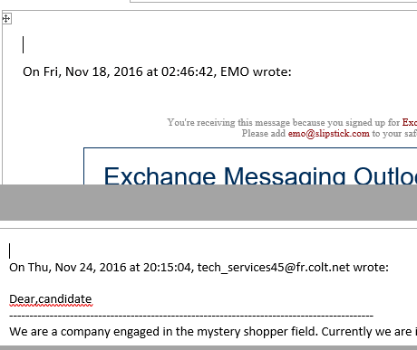

ok... this is a more compact version of the code - it doesn't change the format and uses a different reply header -
this works for all messages.
It uses the word object model, so you'll need to set a reference to Word in Tools, References.
replies will look like this with html or plain text format -
Code:
Option Explicit
Private WithEvents oExpl As Explorer
Private WithEvents oItem As MailItem

do you have any idea why the macro (the last one with word object model) doesn´t work on plain text messages? Respectively it works. But original message will be completely removed. On HTML messages is everything perfect. Thank you in advance.
- is it possible to include in header also sender's email address?
Sure. You can do anything you want by changing either of these lines:
name = oItem.SentOnBehalfOfName
.InsertBefore "On " & datestr & ", " & name & " wrote:" & vbCrLf
to use oItem.senderemailaddress
- with word object model you mean Microsoft Word Object Library in Tools -> References?,
Yes, you need to use the word object 'library' - it's the object model by another name. :)
offhand, no. It might not be copying the original message because it is plain text or insert before is wiping it out. (adding attachments has been known to clear the body.) Not sure if i'll get a chance to test it as i have a full schedule most of the week.
