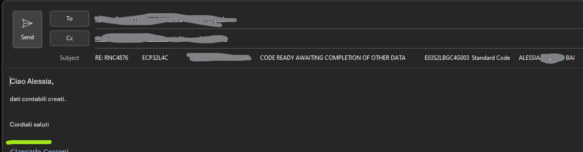

Good morning to all,
I'm doig my first step in VBA Outlook and they are not so "sure". I found some solutions and I try to adapt it to my issue. I need to reply a message (selected) and remove one empty space.
I need to remove CR before signature (Highligted in green)
The code "promise" to do it, but it do not run. What I'm doing wrong?
Here is my code

thanks for your prompt rely, it is not doing what I should do.
The following code do what i should do, but i'm not able to understand what I'm doing wrong in my code sent yesterday.
