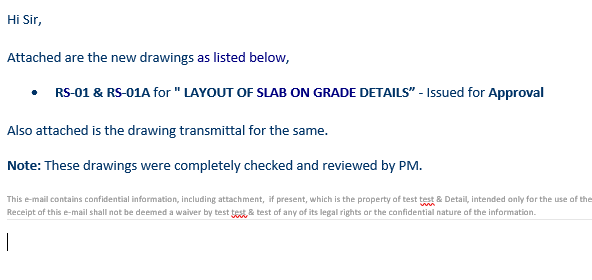

Thanks for your response. I tried this. But I am still getting the old signature (original sender's) only.
And my signature is placing above the whole email body (instead of replacing with sender's signature in the bottom of email body). Please see below my edited code and let me know if I am missing anything.

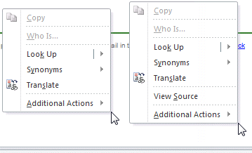

Does the incoming mail have the autosig bookmark? You will need to look at the message source and see what is common in all of the messages you need to use the macro on.
This part of the code is looking for the bookmark:
Set oBookmark = olDocument.Bookmarks("_MailAutoSig")
If Not oBookmark Is Nothing Then
oBookmark.Select
olDocument.Windows(1).Selection.Delete

Assuming this is the signature
As long as the sender didn't add a table to the message, you could look for the table or table class and delete everything to the end.
Code:
table class=MsoNormalTable border=0 cellspacing=0 cellpadding=0 width=357
 style='width:267.4pt;margin-left:.1pt'
in a quick test - setting a bookmark for the first table worked - but the last line of code deleted everything.
Set olSelection = olDocument.Application.Selection
olSelection.Tables(1).Range.Bookmarks.Add "tb1"
Set oBookmark = olDocument.Bookmarks("tb1")
This code deleted everything - could be just my setup (its a test mailbox) -
olNewMail.HTMLBody = "<p>&nbsp;</p>" & strBuffer & olItem.HTMLBody
olSelection.MoveStart

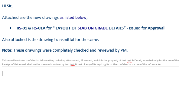

The code below gets me this - but as soon as I try to add the signature to the body, this part is deleted. :( If I move the signature to the bottom, it works. I'm guessing its HTML tags (/body amd </html) in the signature string closing out.

Understood, Thanks for your help. I will try to work with this. Thank you so much.
One more question: It seems that some other emails doesn't have table or table class available (please see below pasted source code). Can you tell me how to change this when table class is not available?
Otherwise the common word for all emails will be "With Best Regards (or) Thank you (or) test@domain.com" (will be placed above signature). Is it possible to remove all texts below these words (including these words need to remove) ?
Thank you in advance.

Didn't have a macro that did exactly this but had one that was close I could cannibalize from.
Code:
Sub TestEmailRedirect1()
Dim olItem As mailItem
Dim olNewMail As mailItem
Dim Item As Outlook.mailItem
Dim strBuffer As String
enviro = CStr(Environ("appdata"))
Set objFSO = CreateObject("Scripting.FileSystemObject")
' Edit the signature file name on the following line
strSigFilePath = enviro & "\Microsoft\Signatures\"
Set objSignatureFile = objFSO.OpenTextFile(strSigFilePath & "signaturename.htm")
strBuffer = objSignatureFile.ReadAll
objSignatureFile.Close
Set olItem = Application.ActiveExplorer.Selection.Item(1)
Dim olInspector As Outlook.Inspector
Dim olDocument As Word.Document
Dim olSelection As Word.Selection
If olItem.Class = olMail Then
Set olNewMail = olItem.Forward
With olNewMail
'Remove "FW" prefix in subject
olNewMail.HTMLBody = olItem.HTMLBody
.Subject = olItem.Subject
.Display
Set olInspector = olNewMail.GetInspector
Set olDocument = olInspector.WordEditor
Set objWord = olDocument.Application
Set olSelection = objWord.Selection
olSelection.Bookmarks("\StartOfDoc").Select
  olSelection.Find.ClearFormatting
For lphrase = 1 To 2
Select Case lphrase
Case 1
  strFind = "Thank you"
Case 2
  strFind = "With Best Regards,"
  With olSelection.Find
    .Text = strFind
    .Replacement.Text = ""
    .Forward = True
    .Wrap = wdFindContinue
    .Format = False
    .MatchCase = False
    .MatchWholeWord = False
  olSelection.Find.Execute
If Not olSelection.Find.Found Then GoTo nextphrase
olSelection.EndOf Unit:=wdStory, Extend:=wdExtend
olSelection.Delete Unit:=wdCharacter, Count:=1
nextphrase:
With olSelection.Borders(wdBorderBottom)
.LineStyle = wdLineStyleSingle
.LineWidth = wdLineWidth025pt
.Color = wdColorGray10
olNewMail.HTMLBody = olNewMail.HTMLBody & strBuffer
It works very fine. Thank you so much for your help.
