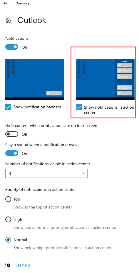

Turn it off in Windows Settings > Notifications & Actions - Under Get notifications from these sender, click on outlook and change the settings.
This is from a test machine so it has the defaults - I uncheck notification in the action center, banners, and play sound. I have the envelope icon option (in outlook's options) because it is not so 'in my face'.
Thanks Diane,
I looked there but thought all I could do was unable notifications for Outlook, I never thought to click on Outlook to see if there were more options. That taught me a lot about Windows 10 from now on I won't look at a slider and think that is a either on or off I will always clcik on it to see if there are more options..
