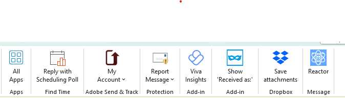

Removing office web add-ins from the toolbar doesn't work - they sync back down after a restart. But you shouldn't have find time - it was retired.
Better is to create custom ribbons with the buttons you want. Put it before home tab and it should display first when you start outlook.

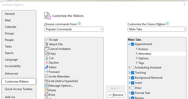

Thanks, Diane. However, I don't think I am trying to remove 'web add-ins from the toolbar'!? What do you mean by this? Please give me an example, as we may be talking of the same thing using different terminology.
What I am trying to customise, i.e., remove, are entries under the Main Tabs, under 'Customise the Classic Ribbon'. These are not 'web add-ins' are they?
Here is a screenshot as an example, if I want to remove 'Attendees' from the Ribbon under Appointments:
If I click 'Remove' and OK, that entry indeed disappears from the Ribbon, but at some point it reappears on the Ribbon (still not sure if only if I close Outlook or also in the same session, when I try to set up another appointment).
Assuming 1 Microsoft account - File > Info page, at the bottom, click Manage Add-ins. Anything on that list is a web add-in. Find time was a web addin (is now built into outlook as Scheduling poll but is still a web-based app).
This was a Microsoft notification to business admins: The FindTime add-in will stop working and be removed from Outlook for Windows, Web and Mac. Scheduling Poll is the replacement feature, which is built directly into Outlook clients for all users as a native feature.
Introducing Scheduling poll in Outlook! | Microsoft Community Hub
Or, when viewing the inbox - click All Apps. All add-ins under all apps are web add-ins. Unless you have a lot of com add-ins, most of the add-ins on the ribbon after the all apps button are web add-ins.
Thanks, Diane.
No, when I click the All Apps on the main Outlook (365, on the windows computer) window (showing Mail), It is empty and says 'You don't have any Apps yet. Select Add Apps to browse and install Apps'. So, this is definitely not part of the issue I am having, which is related to the native features of the Ribbon.

Kika,
Clarification please. Are you trying to remove standard Outlook Ribbon commands? Where "standard" means those commands that are defined by Microsoft? Not ones that you added?
As far as I know, this is not allowed. You can only Hide (uncheck) standard groups. Not remove commands from them.

I am trying to remove STANDARD Ribbon commands. It can be done: I successfully do it and the deed shows when I press OK.
What does not work is that the change does not 'stick'. As I explained, the removed commands repopulate the ribbon after variable and unpredictable lengths of time.
