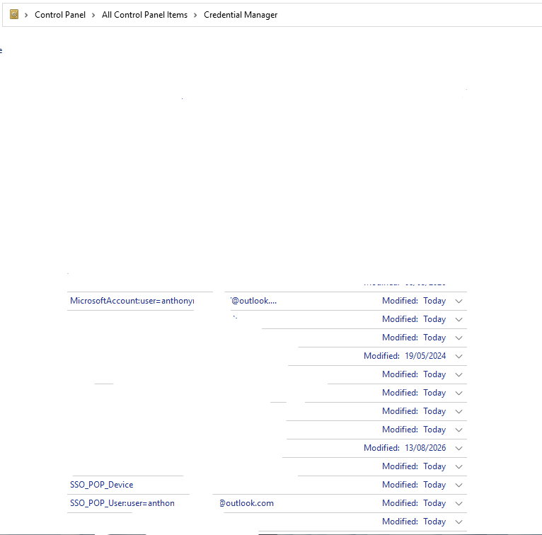

I have seen this reported, and one fix was to use Credential Manager and remove all references to OFFICE, but I think I only need to remove the 2 entries related to the failing OUTLOOK account. The other report suggested removing the OUTLOOK account, and recreating it.
I just need advice on which is best to try. Would an Office Repair be any use?
You can remove the account if the address is under Microsoft account user or SSO_POP but I don't believe those are for Outlook or windows. The email password is stored in windows for all Microsoft account.

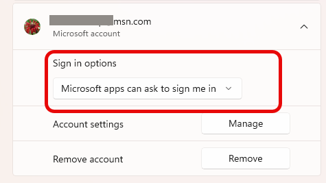

If that fails, assuming it is not the account you sign into the computer with, look in Windows Settings - under Accounts > Your accounts. Is the account listed? If so click Remove. Close Outlook and restart.
If you want to try this before removing, if it is set to "Microsoft apps can ask to sign me in" you can try changing it to "All apps need to ask me to use this account" and see if that forces it to ask for the password in Outlook.

I have not yet removed any entries for it in the Credentials Manager, but it looks like after removing the failing account in the user settings, it has gone from there anyway.

I’d try Credential Manager first and remove only the credentials related to the affected Outlook account. Restart the PC and open Outlook again. If the issue continues, remove and re-add the Outlook account. I’d keep Office Repair as a last step, since the other PC works with the same setup.

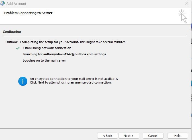

Hello, thank you both for your useful input. I DID try removing the disconnected outlook account, but I found I could not add it back.
I got various errors, and DID try the PIN used for all 3 Windows accounts as well as the known passwords. See first graphic with the "Problem connecting to server".

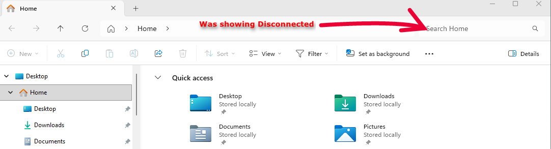

However, when I went to check that the screenshot was in the expected place, I noticed an odd thing in the File Explorer (Home section).
Instead of the usual SEARCH box, it showed "Disconnected". That was of course a red flag, so I clicked on the blue "i" information button, and got a chance to reconnect. Now THIS interface worked really well, and after I keyed over the other suggested email addresses with the bad "Disconnected" one, it wanted the PIN.
After I put that in, I stopped and started File Explorer, at it was fine, like the second picture.
Sorry I did not think to take a screen-shot before I did that, as I did not think it would work.
However, when I started up OUTLOOK again, I could add that OUTLOOK account in just fine, it took less than a minute, then about 6 minutes or so to re-sync the OST file.
It seems that after the ISP outage, things were left in an odd/bad state, and the OUTLOOK UI for adding an account was acting weird.
Certainly I had tried the PIN and password several times.
I don't know enough about the Windows Internals to judge whether this is a bug, lack of defensive code somewhere (e.g. Outlook, Windows Credential API, or OneDrive or MS 365 interference).
FYI: Sorry, forgot to say, some of the attempts prior to doing the Windows Explorer reconnect of that Windows account, showed errors relating to "could not access Autodiscovery.xml". Possibly related to the disconnected account?
