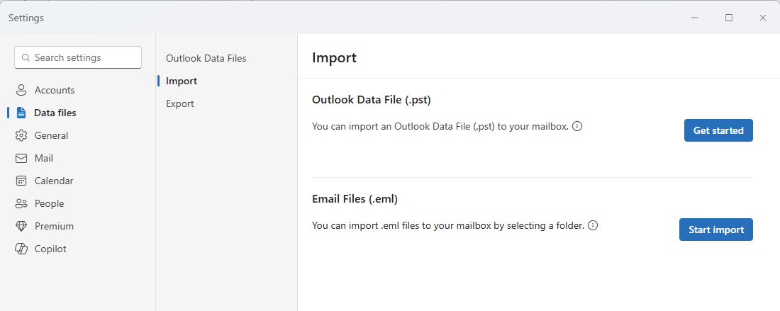

Once I get it removed, could you provide a step by step process to add a POP (xxx@sbcglobal.net) account to OUTLOOK ?
I do have all the server and secure mail key info, I just need the steps.
And after, I would like to (import?) my Classic xxx@sbcglobal.net.pst to Ouloook, so that it will mirror/replicate my current folders, calendar, etc.
Also, will the new .pst data file also show in Documents\Outlook files ? And if so, would it show as xxx@sbcglobal.net.pst (1) while the original Classic file remains as xxx@sbcglobal.net.pst. ?
If you need POP3 and PST files, stick with classic Outlook.
Do you have an Office 365 subscription? That is required to use a PST in new outlook, I'm pretty to import or export - definitely to open a pst in the folder list. Classic Outlook needs to be installed to use pst, although this will be changing eventually.
Microsoft will likely try to sync imported mail back to your mail server, so if your quota is small, you may max out the mailbox.
New Outlook doesn't use PST for normal data storage; it stores mail in a weird database format in app data folders. If you want to open a pst, it can share your current pst. If you want a separate pst, make a copy of the one classic Outlook uses.
Microsoft should add the account to new Outlook correctly, but it will be a cloud account - it will not be a typical pop account like you see in classic Outlook as Microsoft syncs all pop and IMAP accounts to the Microsoft cloud and the cloud syncs to new Outlook.

Selecting "Remove from this device" in the modern Outlook interface or Windows settings will only remove the account profile from the new Outlook app, leaving your sbcglobal.net account and its local data in Outlook Classic completely untouched. However, to avoid any confusion, the safest way to remove or add POP accounts in Classic Outlook is through the legacy Control Panel under Mail (Microsoft Outlook) rather than the main Windows Settings app. From there, you can easily set up your POP account manually with the proper inbound and outbound server settings.
But I gave up on what I was trying to do. It wasn't worth the stress. In addition to needing 365 to add a POP account to Outlook, Hornblower indicated "Microsoft doc says that New "Outlook supports POP, but I've seen multiple reports that it doesn't work for many email hosting services, other than GMail and Yahoo."
New Outlook doesn't actually use POP - it will sync the mailbox to the Microsoft cloud then that syncs down to new Outlook. If the mailbox supports imap, I believe it will add it as IMAP - but don't have any accounts to test it with and verify that it uses the pop protocol - just Gmail and yahoo (which will always use imap.)
You need a subscription license if you want to open a PST in new Outlook - but the email accounts won't use PST files. They store the mail in a cache file that is not readable/useable outside new Outlook.
Honestly, if you have IMAP or pop accounts, no Exchange online (outlook.com or business side), I don't recommend new outlook. Use classic if you have a license or another mail app (I like eM client).
