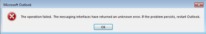

This works fine to access the DPMG Shared Contacts... However, when trying to pull up an individual item in the contact list, it receives the following error.
Here is an example of the hyperlink I'm using: outlook://Public%20Folders%20-%20User@domain.com/All%20Public%20Folders/DPMG%20Public%20Folders/DPMG%20Shared%20Contacts/~Test
Any ideas?

This works fine to access the DPMG Shared Contacts... However, when trying to pull up an individual item in the contact list, it receives the following error.View attachment 1809
Any ideas?
Edit: Upon Googling the error, I found that this error occurs when Google Apps conflicts with something in Outlook. I do have a Gmail account tied to this profile on my computer. To nullify that, I went to our backup computer, created a new Outlook profile and tried following the link. I receive the same error.
