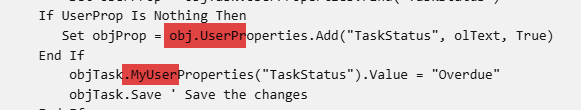

OK, so I now have:-
Code:
Sub UpdateTaskStatus()
    Dim objTask As Outlook.TaskItem
    Dim overdueDate As Date
    ' Define the overdue threshold (e.g., overdue if due date is in the past)
    overdueDate = Date
    On Error Resume Next ' Continue if an error occurs (e.g., not a task item)
    ' Check if the current item is a task item
    If Application.ActiveInspector.CurrentItem.Class = olTask Then
        Set objTask = Application.ActiveInspector.CurrentItem
        ' Check if the task is overdue
        If objTask.DueDate < overdueDate And objTask.Complete = False Then
            ' Update custom field "TaskStatus" with "Overdue"
            Set UserProp = objTask.UserProperties.Find("TaskStatus")
        If UserProp Is Nothing Then
           Set objProp = obj.UserProperties.Add("TaskStatus", olText, True)
            objTask.MyUserProperties("TaskStatus").Value = "Overdue"
            objTask.Save ' Save the changes
    Set objTask = Nothing ' Release the object reference
    On Error GoTo 0 ' Reset error handling
But it is still not doing anything
Two typos. I forgot to change obj to objTask - not sure where the My came from, but removing that and it worked.
Try this code:
Code:
    overdueDate = Date
           Set objProp = objTask.UserProperties.Add("TaskStatus", olText, True)
            objTask.UserProperties("TaskStatus").Value = "Overdue"
Try this code:
Code:
    overdueDate = Date
