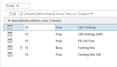

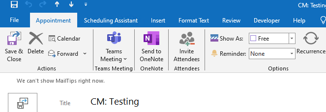

It's working here -
It will show the default remind beforehand time in the list view - but the reminder icon is not present, so it won't go off.
