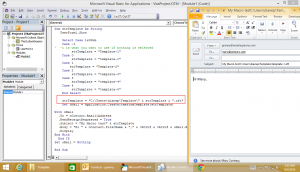

The yellow indicates that line is the problem - the dialog in the first screen shot says the template can't be opened. Did you save an Outlook template with that name in that location?
You can add debug.print strTemplate right before the set oMail = line - it will write the path to the Immediate window (Ctrl+G to open it) and you can verify it exists - then double click on the file and see if it opens for you.

If you double click on the template, does it open ok?
The debug code is added like this:
strTemplate = "C:\Users\Falina\Email\" & strTemplate & ".oft"
Set oMail = Application.CreateItemFromTemplate(strTemplate)
copy the path from the Immediate window and paste it in the address bar of windows explorer - does it open?
File permissions should be ok since its under your user account, but you can verify that as well.

the version won't matter, 2010 and 2013 are essentially the same for VBA. In fact, this macro should work in 2003 and up, and will probably work in 2000 and up. But I will test it to double check.
I tested it -- it worked when the path was correct.
Are you using the same case for the template names? It usually doesn't matter with filenames and didn't here.
I was able to trigger the same when i forgot to change the username in the path - there is no "C:\Users\me\Template\" - and for whatever reason, windows told me i had a Templates folder in that path already so i used Template. (I'm showing hidden files and folders and don't see the Templates folder.)
I added the template path string to the subject so i could see which template it was loading - I triggered the same erro you got only when the path circled in red was incorrect.
