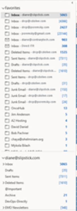

After really zooming into your third image above, I noticed that it doesn't have tight spacing at all. It's just that the lines are so long for the first half of your Favorites that I mistook it to be. The rest of it, including, most importantly the Inbox itself at the bottom, is very broad. And I think that was your best-case image.

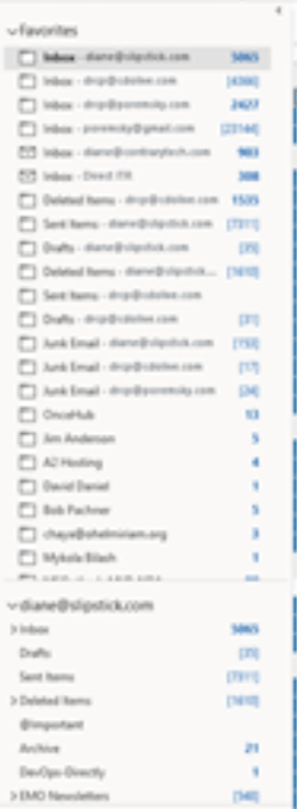

This is of renewed interest because I tried installing the latest build in a VM and do NOT see the problem I've been describing. In fact, the spacing is extremely tight, closer even than I remembered being possible:
So, there's another variable in play here such that in a clean install the spacing is like that automatically but otherwise you're out of luck. I assume it's some other part of the Office Registry.

The switch from a space to block right is by design. As far as I know, a fix for the navigation pane was not about the number position but with the ability to shrink the pane - this is currently about as narrow as it will go - next step down is collapsed. I believe at the time of my earlier screenshots, the navigation pane's smallest width is the one in the screenshot you enlarged. So progress.... just not what we want.
When you say "from a space to block right," does that mean right-justified? I'm not really sure what you mean by that.
In any case, you tend to have very long folder names, which I think makes this whole thing a non-issue:

But when you don't:
