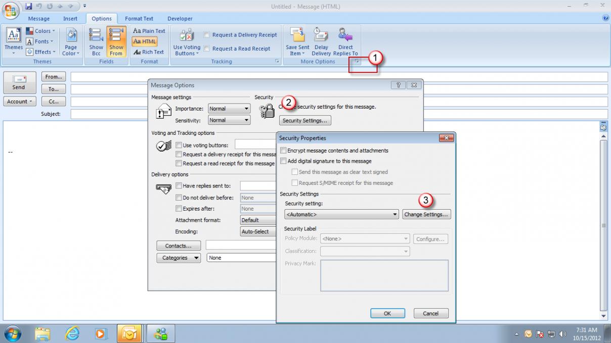

Check the security certificate settings. Open a message, then open the options dialog (click the expand button in More Options) security settings, change settings.

Try new message -
When you click #3 there is a Choose button where you select the new cert.
Security settings should be in options too, but I'm apparently blind because I thought it was under Other tab but can't find it. :) Oh, I am blind... it's on the trust center... i only use 2007 for testing and forgot it has the trust center separate from options dialog. Look in Email Security - is the new id selected?
Try new message -

Unfortunately, there are no changes to make in 'settings.' "Choosing" either certificate results in the following...
Which only compounds my confusion. I have up-to-date certificates from the OpenMail site in IE (and no out-of-date ones that I can find), but I have an out-of-date one popping up when trying to access my mail in Outlook (2007) and have no certificate to 'choose' changes for in the settings noted by the Forum Admin and you, Diane ! :confused:
