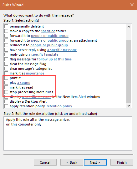

First, the "stop processing more rules" item is actually processed BEFORE the "Run a script" item, so when both are checked, the script NEVER RUNS. Stupid, but repeatable.
