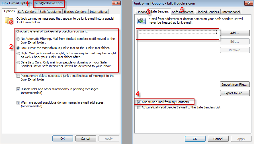

This is the junk mail dialog.
Step 1: Confirm the correct email address is in the title bar. If not, select a folder in the account or an email message downloaded by the account then open the junk dialog.
Step 2: Confirm the junk setting. I think low is default. Try High.
Step 3: Is her address on the safe list? I'd actually probably remove your address from this lisy, if its on the same domain.
Step 4: Are you trusting contacts? If so, a contact for your address means if spammers fake the from address, it will be trusted.
Step 5: Check the Safe list for her address. If you are on the same domain, you may not want your address on this list either.
Yes, her address is correct on the title bar.
I changed to High.
I assume this is the safe senders list. If so, I added hers. Mine was not on it.
It was, so I unchecked it.
Since I only see a safe senders or safe recipients, which one? I did safe senders as in your step 3. Safe recipients is empty.
Thanks again
Man this issues sure is so far not an easy one to figure out.
Re: Two accounts, Junk email filter only works on one account, office 2010, po
For now, I would remove both of your addresses from the safe senders and recipients lists and see if it helps. You'll need to check the junk folder to see if its catching good mail - then add those names to the safe lists.
